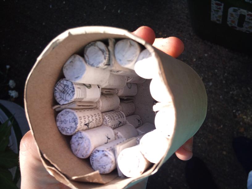

I have made all the Beraq, they just need the delays adding. The shell is designed to have one ring of beraq half Orange / Aqua. The Aqua flash is very new, looks good close up but not sure if its as good far away. We will see, anyway here is a test fit picture. After they are finished the card spacers will be replaced by thin wooded ones.
Total Beraq,
18 No - 5/8" ID Orange
18 No - 5/8" ID Aqua

When you say 50:50 PVA:water are you talking a 50% solution of solid PVA in water, or a 50:50 mix of white glue and water?
#1566 karlfoxman
  • 1,139 posts
Posted 11 July 2010 - 07:40 PM
Mumbles, this is meant as White glue / water 50:50 mixed. This is just used to dip the beraq and fill any holes. Also stops the spiking unwinding.
