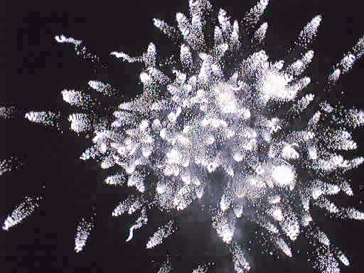

Made a few shells in the last few days with varying sucess. This is one of the ones that seemed to work out quite well.
Shell was 2 3/4 ID Canister shell with Winkour 20, Green and Purple and a few bits and bobs of old stars I needed to get rid of.
Break was around 10g of Bp coated rice crispies with 2-3g flash plus granulated Bp between stars.
http://s85.photobuck...ketspics002.jpg
http://s85.photobuck...ketspics005.jpg
http://s85.photobuck...ketspics006.jpg
http://s85.photobuck...urrent=1008.jpg
Video..
http://pyrotechnics....shellw20cut.wmv
Although I was quite pleased with this shell I was quite dissapointed with the colours. Green was Shimizu forumla which came out more white then anything and the purple was slightly better but still not great.
Any comments/critisisms?
There is a very fine line between “hobby” and “mental illness.
