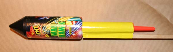

Thought the next size up 'War Hawk' might be better.
Impressive cone - must have lots of stars!

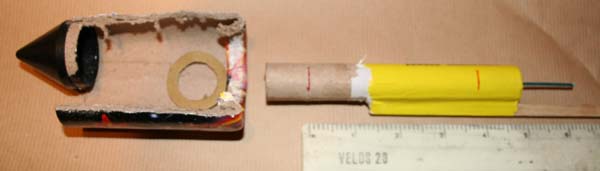

Well actually, nothing but fresh air!
The marks on the body show the total length of nozzle + motor + garnature, so even that's not full!
How to they get away with this blatant deception?

I have enclosed some pictures which illustrate the problem.
The rockets would appear to have a large heading of stars, but when you look inside, the headings are completely empty, along with quite a bit of the motor tube! To give this it’s kindest interpretation, this is misleading, suggesting that you are getting a much larger rocket than you really are.
There has been recent legislation, making it difficult to transport rockets that have more than 20g of active components, effectively making it impossible to retail large rockets at normal outlets.
The type of rocket you sold this year gives the appearance of the older type of rocket, but can only disappoint customers with its performance and generally give fireworks the reputation of being poor value for money.
We would request that if you can, you ask your suppliers to provide products without this ‘window dressing’ so that customers get a realistic idea of what the performance of the product will be.

Motors were pretty nippy, but the headings were poor. The tiny stars were of course very short lived. The performance of the ones with the large pretend cone were no better than the ones with the small pretend cone.
I put 7g of flash in them and used a flight of 40 of them to start a show - now that was quite effective...
