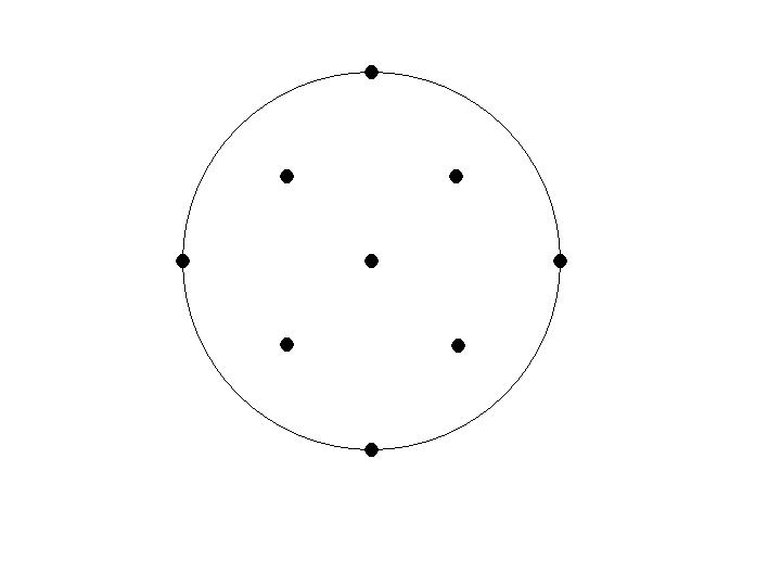

Just to add, pasting can be done by changing the poles method, you start and stop just short of the poles so you don't get such a build up. Overlap by a quarter on the equator so for every four complete pastings you gain one. Go round all the poles once then repeat four more times on any four poles of your choosing, giving you a total of thirteen, with overlap sixteen. It pays not to add more poles as it can get confusing. This is based on 4” shells so on a 3” you would probably get away with just the the nine full pastings.

I am having difficulty finding information about how to paste shells properly. I have been using the 3 strip method with success but you are not supposed to get build up at the poles and i am getting that so i presume i am doing some thing wrong. I place 1 strip top to bottom and one next to it over lapping at each pole and in the middle barely touching. i repeat this many times over to get my desired diametre.
Do you guys no of any better ways or even easier ways to do this, some diagrams or maybe point me in the directrion of some online info about it.

The easiest way around pole build up is to not use full length strips. Leave about a 3-5cm hole on each pole for a 4" shell. When you complete a rotation, use a few short pieces to fill in the holes at the poles. I do it this way, and the shells come out pretty much round, and there is really no build up anywhere.
As far as changing the location of the poles, I only use 3 locations up to shells 8" in diameter. I use 3 poles on the axes of and X, Y, and Z coordinate plane if that makes any sense, on the vertices of an octahedron. One that includes the fuse and top of the shell. One along the equator, and one 90 degrees rotated on the equator. I've seen that 9 pole pattern before, and find it not optimal as it will not result in equal coverage. There are 8 big chunks that don't ever get a pole. I'm not saying that it won't work though. There is a 7 pole pattern that gives somewhat better coverage. Every pole is equidistant from it's nearest neighbor. It's just the diagram that fflach posted with the additional poles rotated 45 degrees, which removes 2 sets.
