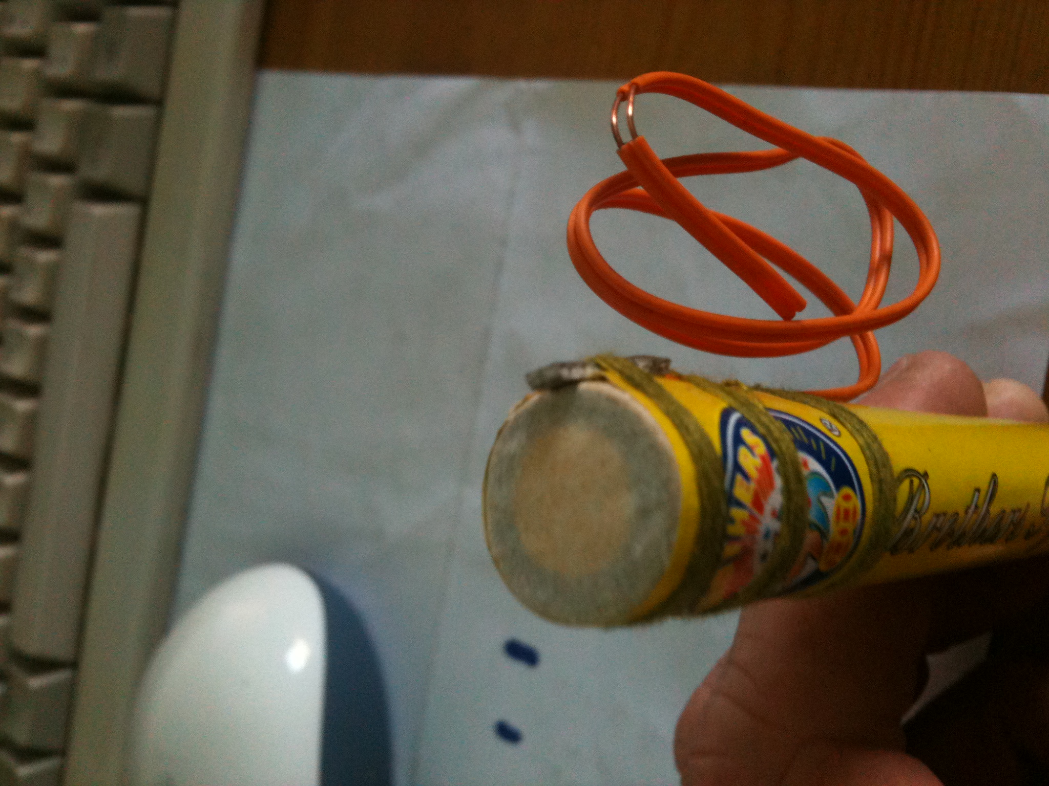

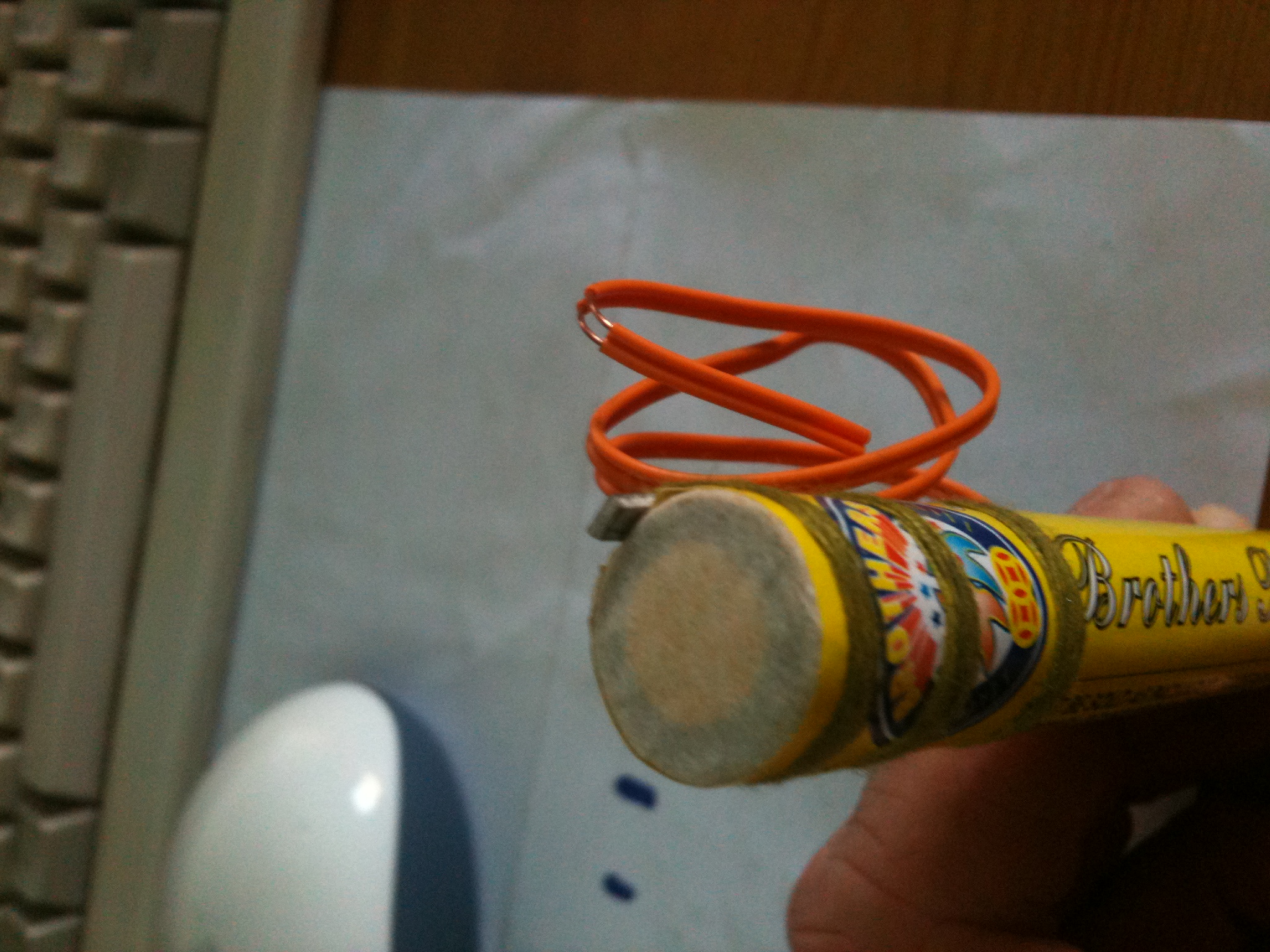

Im currently working on a project for a friends company which involves electrically firing an indoor gerb.
Restrictions are very clear on smoke and we are struggling largely because of the smoke emitted from the e-match rather than the gerb its self which is 99.9% smoke free.

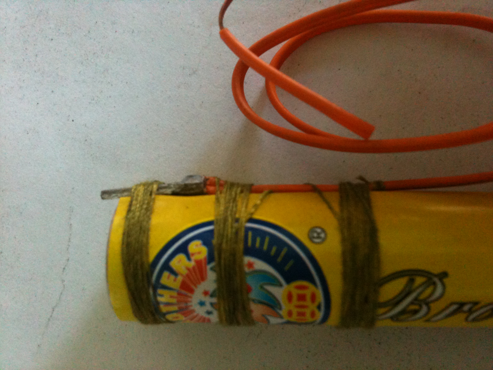

There is also a secondary issue that if the e-match protrudes across the top of the tube it disrupts the very gentle flow of gasses out of the top and splits the fountain into two when lit, to cure this we intend to side mount the e-match and use something to pass the fire across the tubes surface.
This is where I come in. I'm experimenting using my pyrogen-less e-matches to ignite them without smoke, but as most of us may know the tip of the e-match glows for but a split second and this is proving less than reliable in igniting plain NC on its own
Has anyone any suggestions as to VERY low or non smoke producing comps I could try as a pyrogen and passfire to the top of the tube as there is no fuse but only flash paper across the top of the tube (as in tight across the tube not like touch paper which is loose and twisted)
Any suggestions or help are appreciated.

The tops of the tubes as the pic shows are flush fitted paper and as sensative as flash paper is it still takes a little prompting to get it lit reliably, I can use tiny amounts of my standard pyrogen to act as an initiator but still see the need for an intermediary, smokeless comp to passfire. Ideally one that can be applied wet to the top of the e-match and the tube too to connect them properly
even esters igniters have smoke and a main issue will still be that it needs to be on the top of the tube which effects the output flame too much into a split jet.
