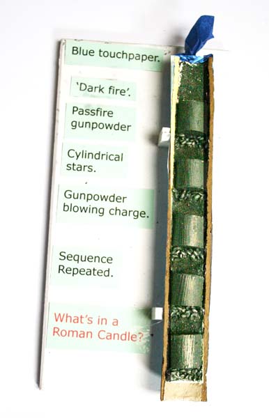

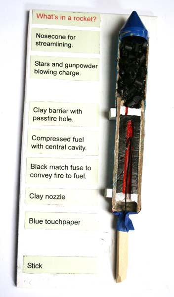

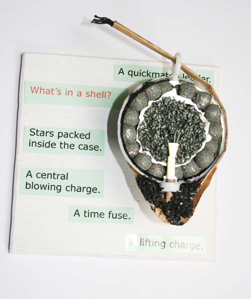

Thought peeps might like to see the cutaway models we showed at Stanford Hall.
They attracted a lot of interest from the visitors, pyros and general public.
Something like them will end up at the Amberley Museum.
Candle made by my son Matt, shell & rocket by me.

Nice, Im trying to work out what you used to make the stars!
#3 phildunford
Posted 06 August 2010 - 03:24 PM
The cylinder stars are bits of wood dowel, the ball stars are aniseed balls dipped in pva and rolled in charcoal! lol
(the large grain powder is arborio rice mixed with pva and lampblack)
