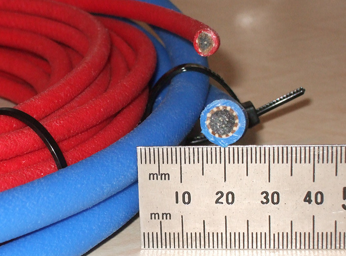

pyrotechnist - apologies seem to have lost one of your posts (clicked the wrong button...)
I'll take some pictures of the PL10 when I have a moment. From memory it has what looks like a plain cotton central core wrapped with BP soaked cotton strands (25g / meter of BP). Around this there is a counter wound cotton jacket followed by approx 1mm thickness of polythene. Overall diameter is 10mm.

OK, Monetti PL5 and PL10 samples:

Posted 29 November 2010 - 09:09 PM
Looks like a very nicely made fuse! how quickly does hot polyethylene dry once out of the molten solution? Them fuses sure do have a thick coating, by the way does the entire fuse burn away?
i had the chance to use this fuse to go into plastic gammon shells (which fits right in without any adjustments, very nice stuff.
it does not burn the outer layer, lol that outer layer is very tough and waterproof, the core is so big it catches light really easy
