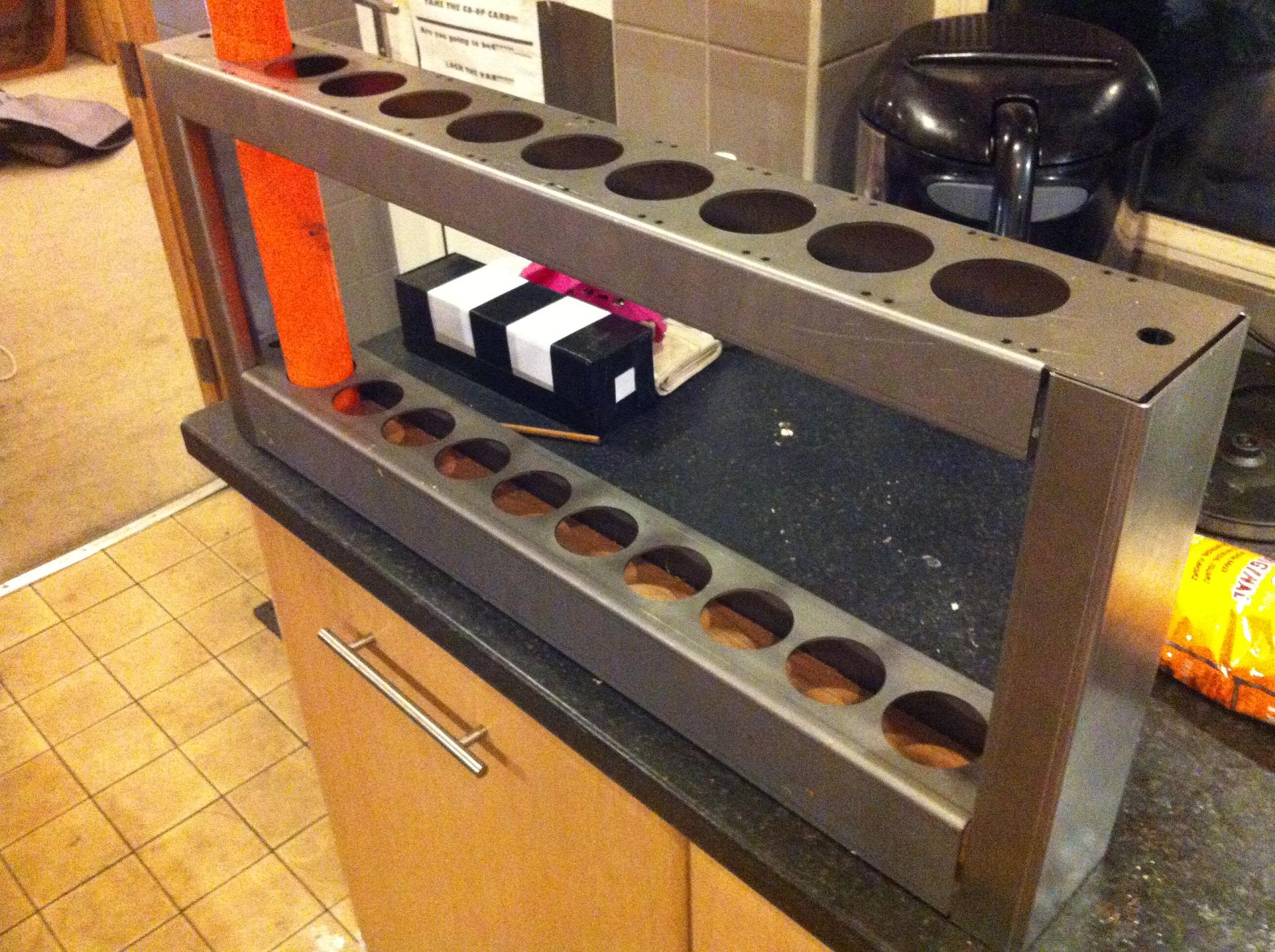

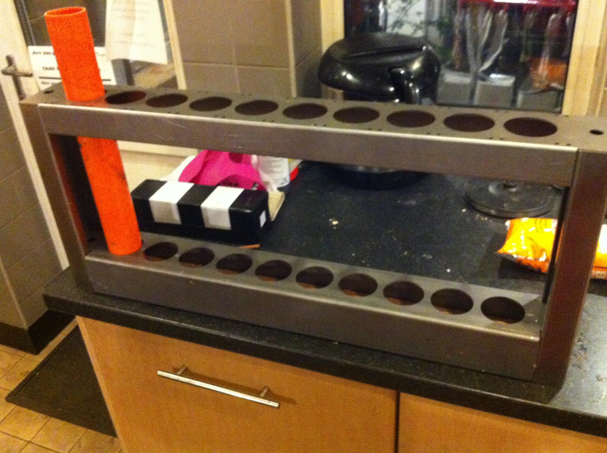

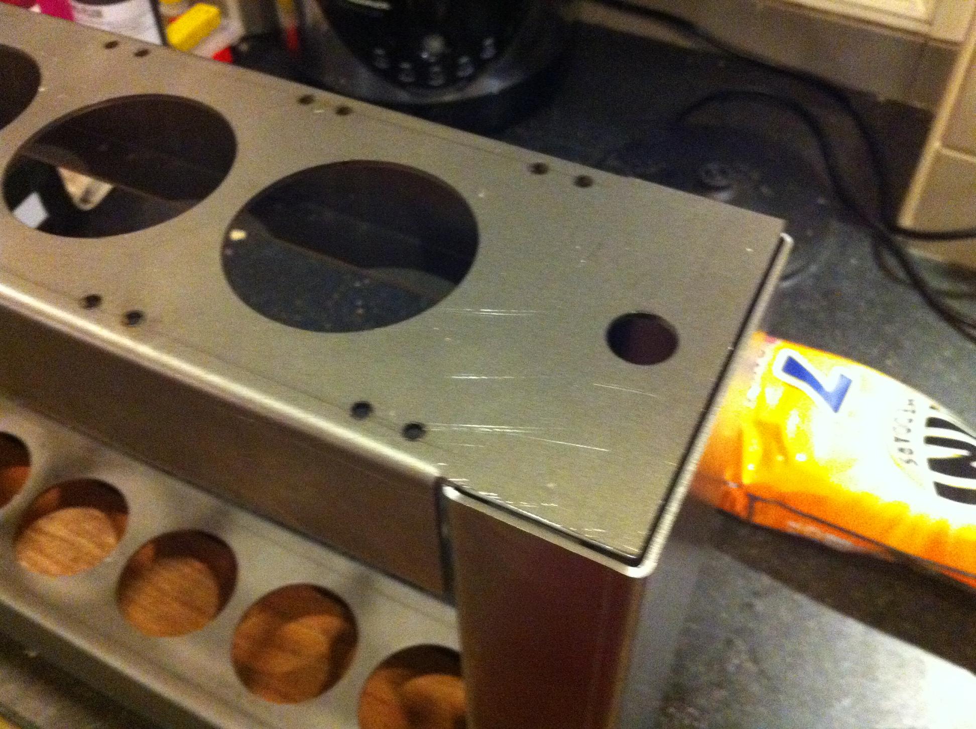

Well faster than I though I have a 2" prototype now.
Pretty much all there but for a few minor adjustments to make welding easier without having to grind anything first and one hole slightly off from where it was supposed to be.
Base is 3mm and the sides and top are 2mm thick, weight is actually less than my 2" racks were made in 25mm plywood which is suprising and nice too.
the small pairs of holes are for a loop of metal to be welded into to act as the tie down points for leaders or igniter wires btw
Tell me what you all think

I like them, they look very strong.
A few thoughts, NOT criticisms.
I could not tell from the pictures what the tubes would be bearing on, presumably ply or something fixed inside the lip of the bottom channel. Is this replaceable with the uprights welded on, or does it need to be slid in from the end.
The deep channel looks as if it would present a large surface area in the event of a shell failure in the tube, this may or may not matter.
Is there plenty of room to get your hand around the upper channel to carry them when they are loaded with tubes, and you would not want that inside edge to be sharp. It's also often handy to have a grip of sorts along the ends to shiggle the rack into position, but that's a very minor point.
Are you going to galvanise them, it looks like a lot of surface area, but perhaps no more than conventional box section.
Out of interest, is the chanel a standard section, or have you had it bent for the job.
Would it be an option to punch up the tie points, it looks like that has been done on Diggers.
Overall they do look very professional, impressive.
Thanks for sharing.

Indeed yes the tubes are sat on 1"ply, which we have now incorperated a cutout on the side panel to allow insertion after welding, this it to allow replacing of it later in life and the ability to galvanise, electroplate or powdercoat them as 100% metal parts, painting could be done with the wood there if wanted.
the dep chanel was one thing I picked up on too but after looking online at NUMEROUS tube failures they ALL filaed some distance up the tube, never that I saw directly at the base, this said dont forget theres a 1" stand off from the bottom of it to allow the wood so a 80mm deep section has just 55mm length of tube inside and then theres the plug of around 1.5" for the 2" tubes in question. This leaves just 17.5mm of "tube" inside the bottom section. larger tubes have an increase in depth to take the extra forces but are made to take the plug depth into acount too.
Also with the new side entry point for the wooden base there is a venting place fro gasses rather than the sealed box we have on this one.
Laser cutting doesnt leave burrs, the edge is not "sharp" but if you ran your hand down it at full pressure you could cut yourself, Im planning on running a sanding disk down the edges we will grab with my anglegrinder before construction starts to make sure there safe though. yep there easy to grab from the sides.
galv, electro plating, powder coating or painting, its up to whever wants them I can get the lot done easily, cost could be prohibative but if loads done at once then cheaper. Powder coating is my favourite option as colours are nice :-)
the whole thing is made from 1 peice of laser cut 3mm (for the base) and 3 peices 2mm (sides and top) sheet steel then bent into place.
Im putting 4mm bent wire loops into the two holes to act as tiedowns, if pressed up from the sheet its self we considered it a loss of structural strenth and would have added quite a bit of cost too. this way you can use them as is or put the wire loops in as I will do as such a prominent loop is a lot easier to use I find.
Ill do destructive testing once a full set is delivered as we were ironing out the bugs in this one first, I think I already spotted most of the issues you found but if anyone sees more PLEASE say now or ill go into full production with an easilly trectified fault :-(
