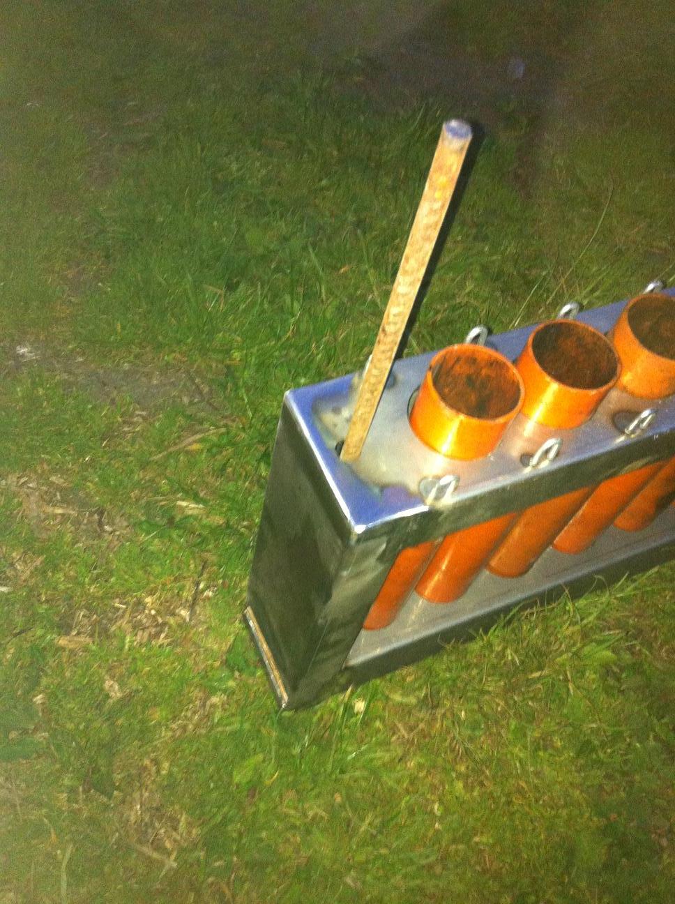

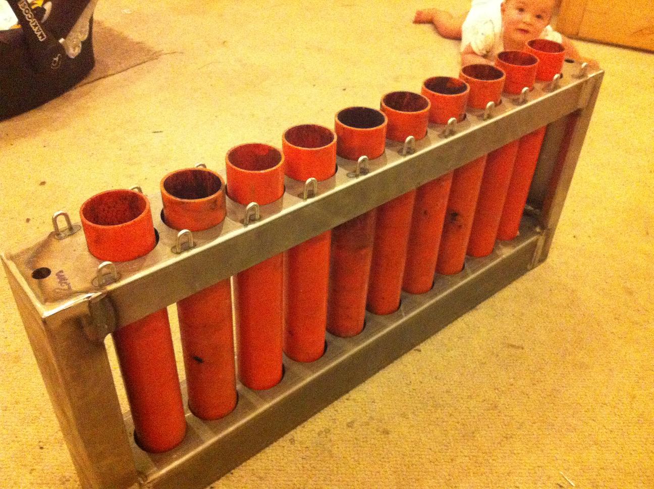

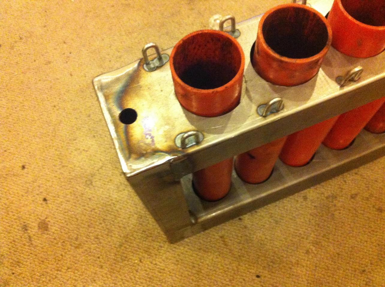

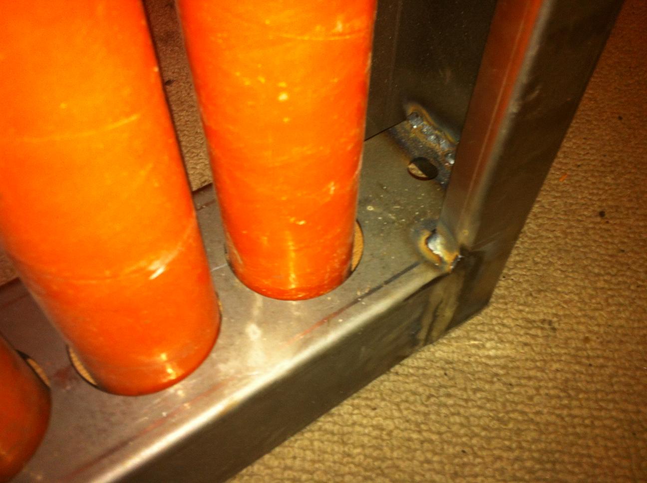

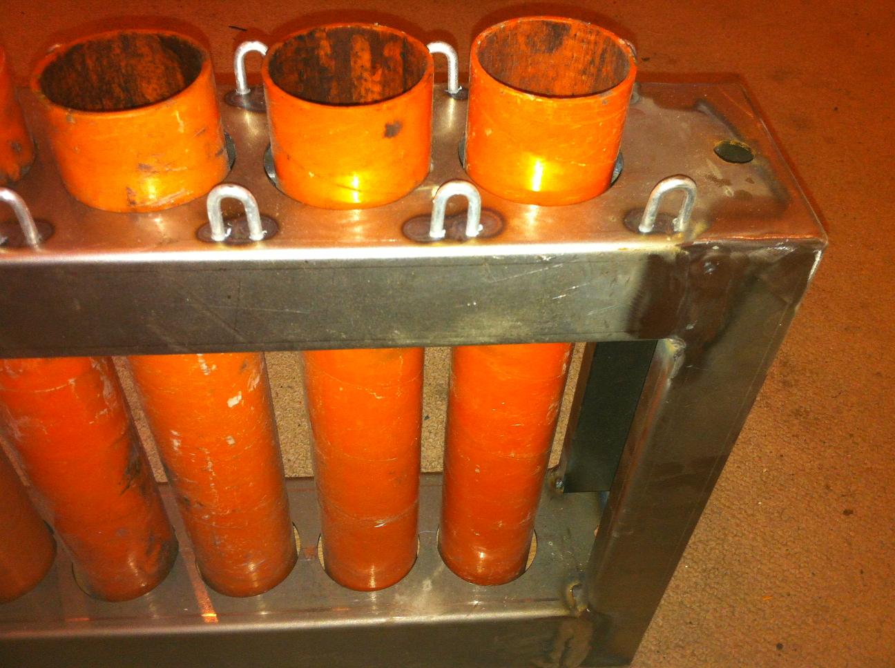

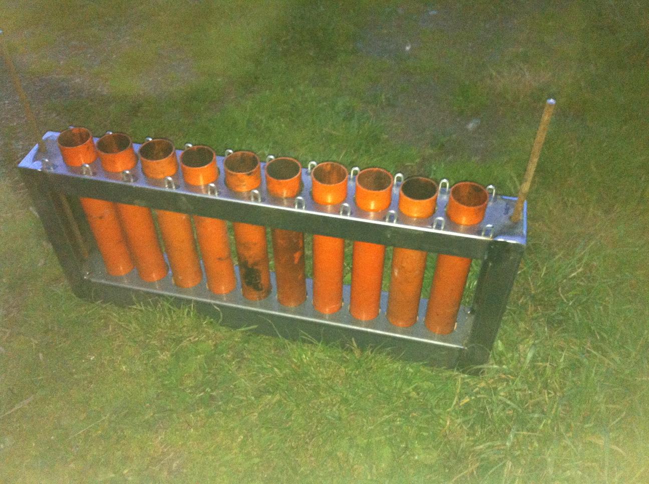

Ok got the first one welded up now, Ive cut the hole as per the next prototype will have to insert the wood and it looks good.
Ive as I said altered them slightly to a part modular system now with pairs of racks in same length sets to allow similar sized racks to be used together, I see this as a pretty good comprimise as large shells wont go with small ones anyway.
need to make the pin down holes larger to allow thicker pins, I intended to use 10mm but after hammering one in think 15mm ish may be better
apart from that it looks good now I recon, tell me what you lot think though please

I think they look really good. I like the ideas of the loops.
I would try and get the 2.5", 3" and 4" all the same length. We use 2.5" & 3" a hell of a lot with a 3" in the middle and 2.5" on the outside or vice versa, makes some great fans.

I looked at making them all the same yes but due to the length they worked out at naturally those pairs were just a maximum of 35mm diferent so very little modifications to be made and almost no weight added, to make them all the same would ahve meant a 150mm extra section on two and 130mm on another two which would equate to a lot of weight and more cost.

If I sacrificed some of the spacing between shells then yep making them all the same length is easilly doable, BUT Ive gone for decent gaps to aid safety in the case of CATO, Id rather have very safe racks than convinient lenths :-)
If I remember right the 2" one came out as 7.1kg on the paperwork, could be less as it may have been when they quoted them to me made of 3mm throughout and now the top n sides are 2mm. DONT quote me on that though,

Are the pictures of a 3" rack? they are closer together than mine.
#26 cooperman435
Posted 25 May 2012 - 09:53 PM
no its a 2" with 10mm gaps

I think I have 17mm maybe more on 2" I will have to dig out the drawings. I did try and get as much space as was reasonable without sacrificing count.
P.S. not argueing. If were to do mine again I would make a couple of changes to make the mounting system slightly different and I would change the detail on the tie off's slightly.
But I have to say having them all the same length is pretty useful, it can be done without sacrificing / wasting space or count. It does take a bit of design time on CAD moving things around until the best fit on length and count is found.
One of my main design aims was to present as little area to a CATO as possible. Hence the low profile sandwich at the bottom and round tubular connections between the top and the bottom. There has been a detail change to the bottom since the pictures were taken.
What I do like about your racks is the minimal welding. They have given me an idea for a new design.
