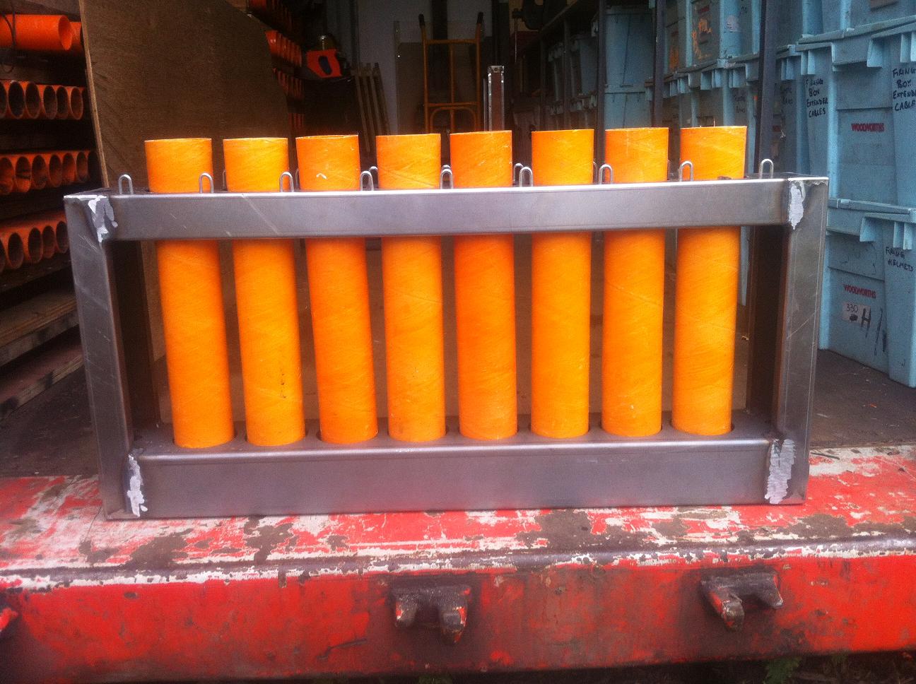

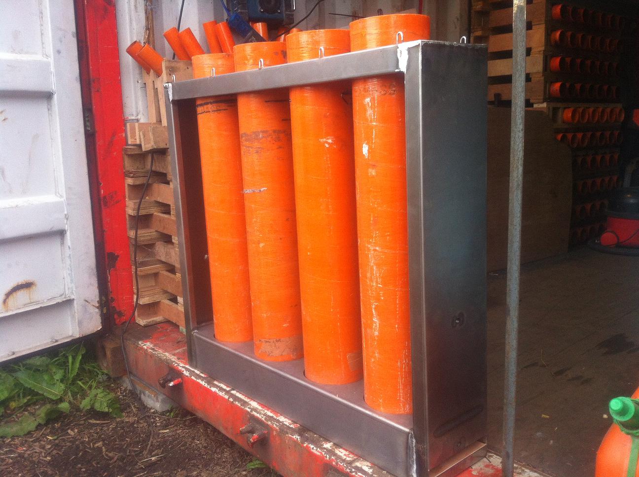

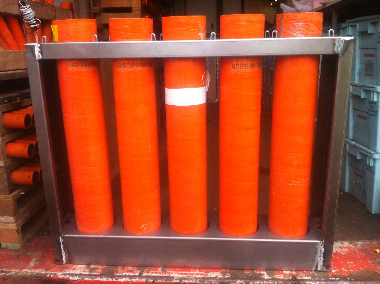

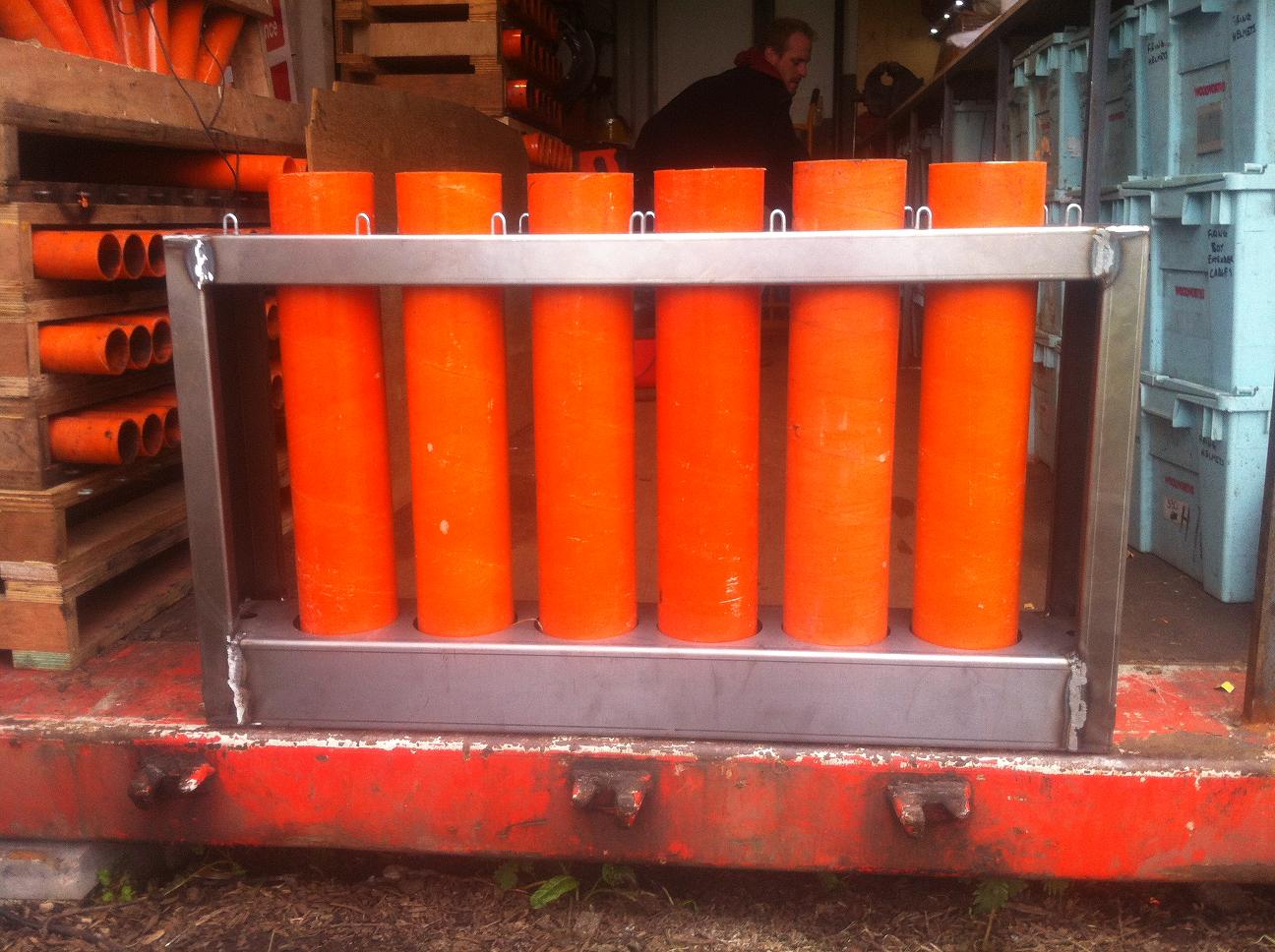

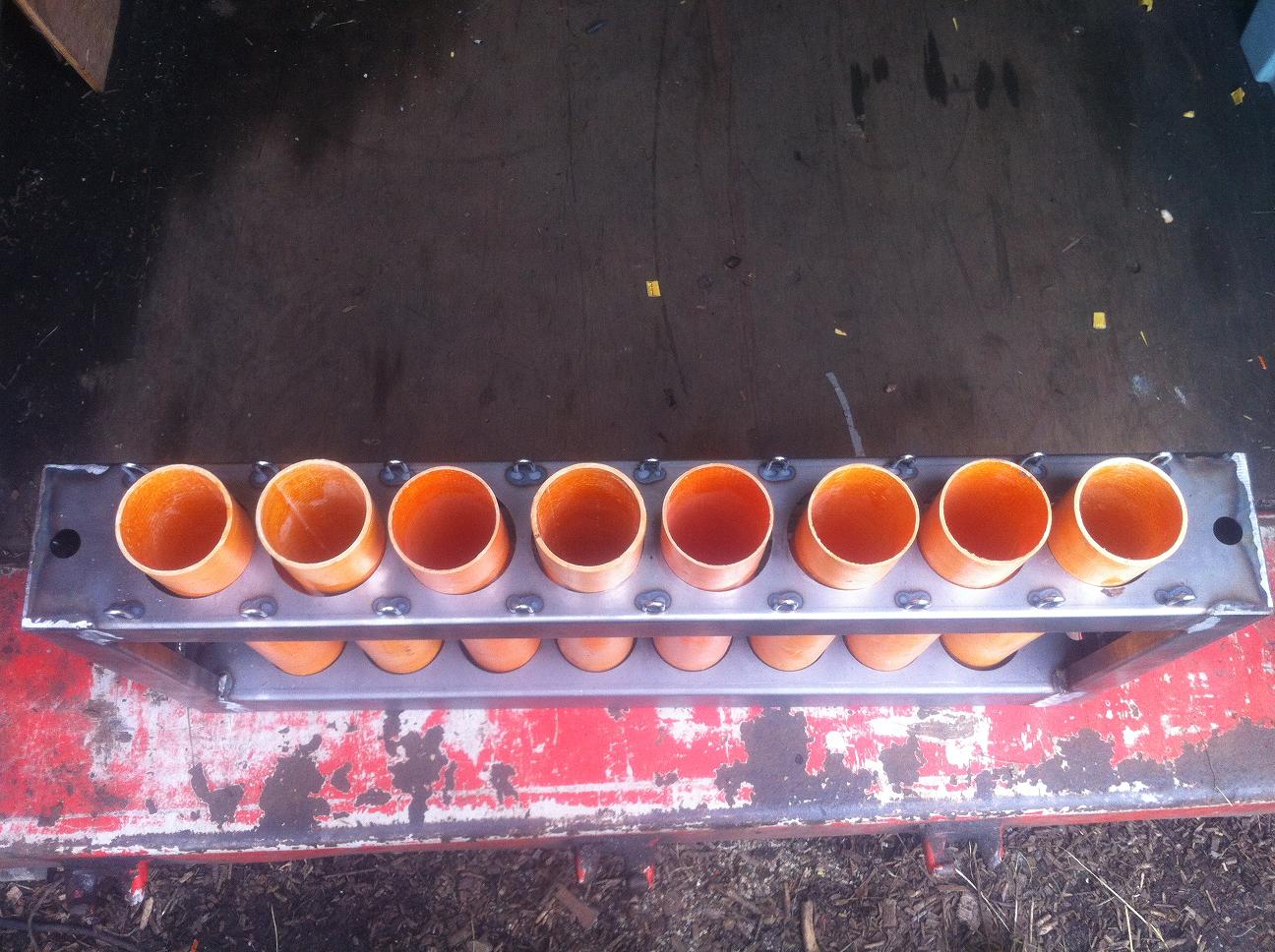

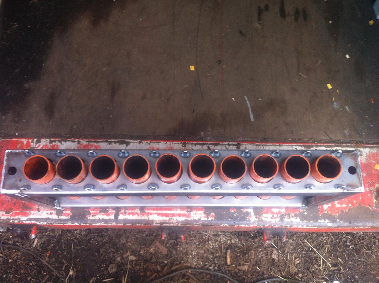

#41 cooperman435
Posted 14 June 2012 - 11:15 PM
getting there now, pics of the whole family together and a few of the individuals

#42 Karl Mitchell-Shead
Posted 16 June 2012 - 05:56 PM
Yeah they look the part Phil, good job.
Are we anywhere with costings and have you made a decision surrounding protective coating (Galvanised, electroplated etc)?

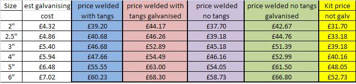

#43 cooperman435
Posted 16 June 2012 - 06:44 PM
pricig stands a little more than I hoped BUT I really like them and they do look the part :)
Im definately going with galv got it priced already n its really no more than proper painting with a lot less work and a much better level of protection.
These prices are quoted as single rack runs, as Im ordering over 100 already anyone ordering ASAP would get discount as will I for bulk, and if ordering enough (probably 10 or more) would get discount too at the time.
A bitmore than I hoped but they are sturdy now Ive them to play with.
Edited by cooperman435, 16 June 2012 - 06:58 PM.
