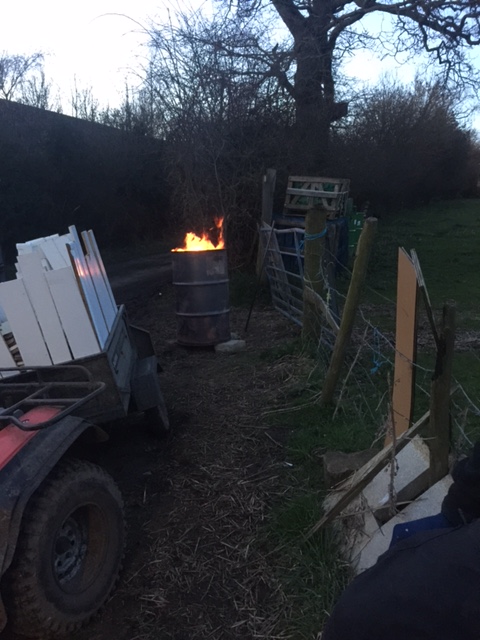

I had a charcoal burn to celebrate the new position last night, I'd run out of pine charcoal and wow did it take me back to the good old days!

Deano wouldn't it be better to put the tins in the other way up to stop ash from the fire going into your charcoal? It also means the burning gasses from the wood being charcoal help heat up the tins too :-)
For me it depends what I'm making. If it a specialty batch for testing purposes like PhillD mentioned then I'd use the retort method (any metal container that will restrict free air flow around the wood will do, tin cans, paint cans with lids, old pressure cooker etc, just be sure there is somewhere for the vapours to escape)
If I'm making large batches then I use the open retort method of continually adding wood into a sealed bottom barrel and allowing it to burn off to charcoal before adding more wood, it starves the charcoal below of oxygen due to the flame using it up, requires no fuel at all apart from the wood actually being charcoaled, produces a container that's actually full of charcoal when finished too, hardly any smoke and it can be used to make full drums like mine in s few hours !
