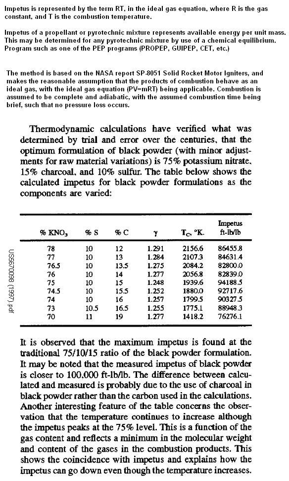

BGP Formulation and Impetus.

Method to determine the BGP Impetus in relation to the percent ratio.

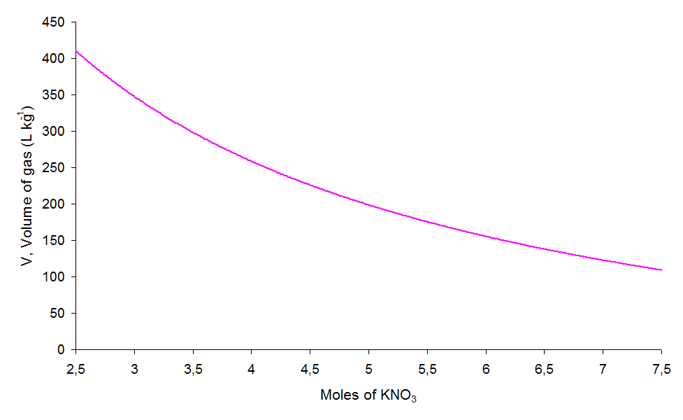

Gunpowder: Volume of Gas.
Kinetic energy, Ek = ½mv2 https://en.wikipedia.../Kinetic_energy
