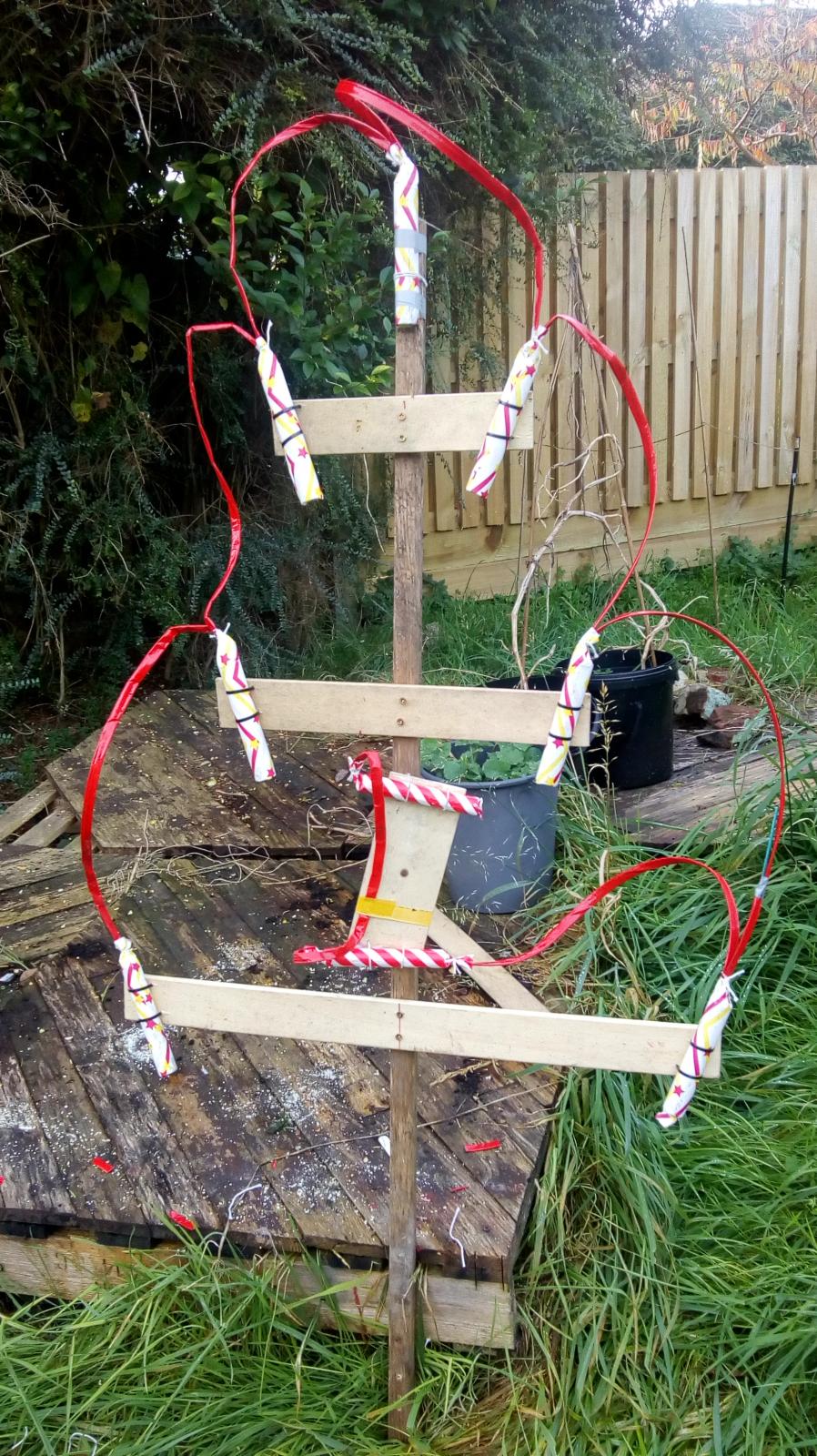

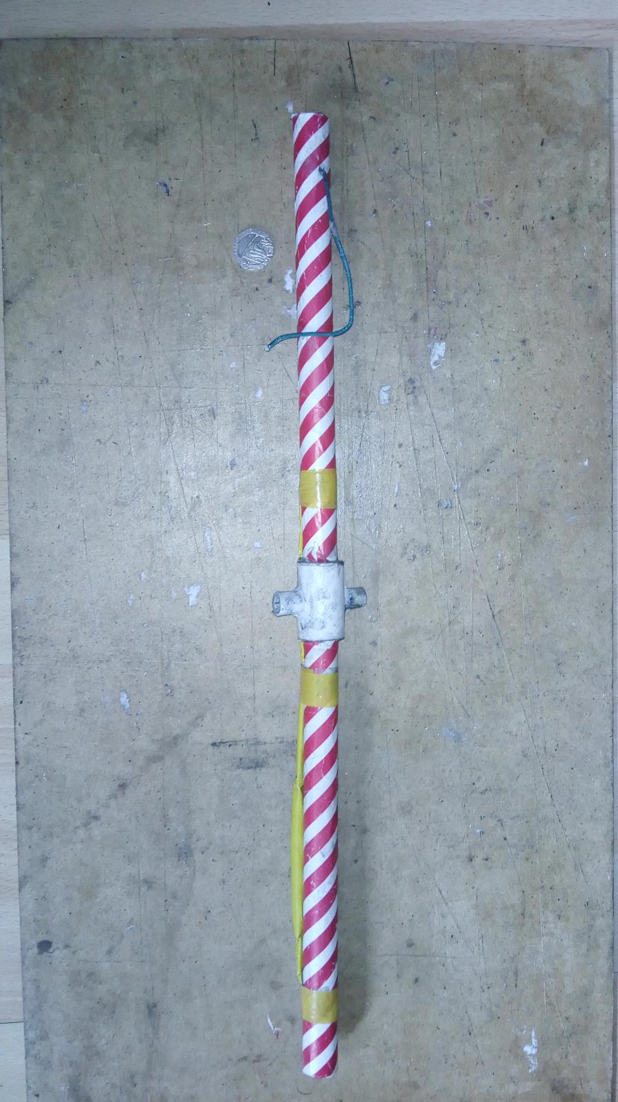

In the meantime, here's a photo or two. First a Saxon made with Lancaster's mix from his book and secondly a tree of gerbs which was ok, but the wheel failed to spin.
The tree of gerbs.

Tree of gerbs
Double Saxon

Thanks peeps. They were okay.....need a bit of work but it's a step in the right direction. I shall definitely improve on the saxon.

I am pretty sure I know the problems with the Saxon after dissecting it after firing.
The case was made from newspaper (It was a case I had made for something else and never used) and the layers flaked and clogged the tube inside and also each case needs another jet hole about half way up rather than just one in the end.
Pretty minor stuff really. Next time I'll fix a colour case on it to get a pretty circle too.
