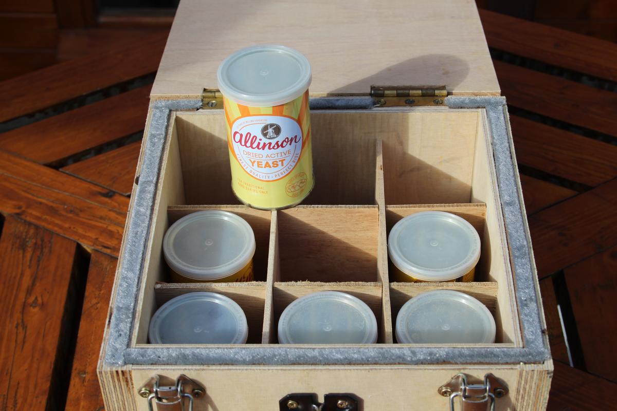

Posted by BlackCat on 05 September 2020 - 10:41 AM
No problem but, for the sake of clarity, yes he did approve the yeast tins on the grounds that the lid is plastic and would easily blow off if there was any pressure build up inside.

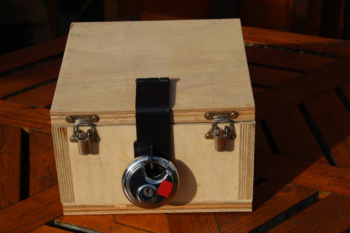

Hello Jon, like you I only need a small quantity of granulated BP to pursue my interests. As Arthur suggested, I made a cut down version of the ply box and I've attached a couple of pictures for you.
The box is made out of 18mm ply, just like the "official" one and measures 240mm x 240mm x 155mm high externally. The tins I use for storage are about 55mm in diameter and 90mm high and contain up to about 200g of BP depending on it's grain size. The tins originally contained Allinson's Yeast and they can be found at any supermarket, however, you'd probably have to take up bread making to make it worthwhile buying them ! the plastic lid fits snugly on the tin but isn't tight enough to allow any appreciable build up of pressure in an accident.
The box has been approved by my ELO but, as Arthur says, you should consult with yours because they frequently have their own opinion of how things should be.
